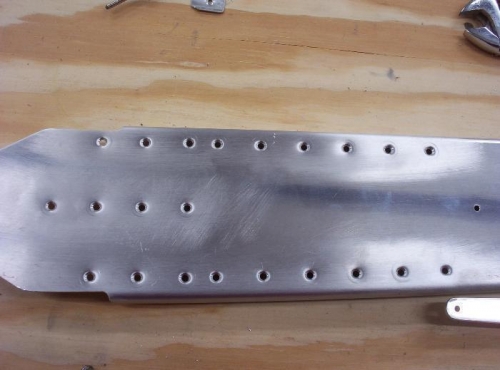

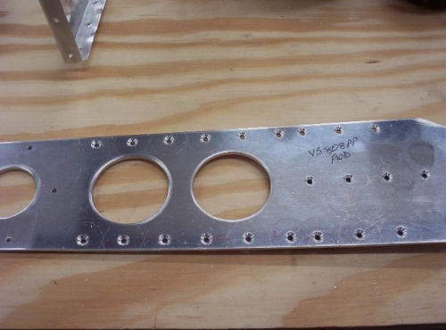

Today I machine countersunk the forward side of VS-808 to accept the dimples from VS-803 that I made with the rivet squeezer using a longeron yoke.
Machine Countersink VS-808PP
VS-803PP Dimpled
