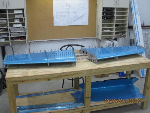

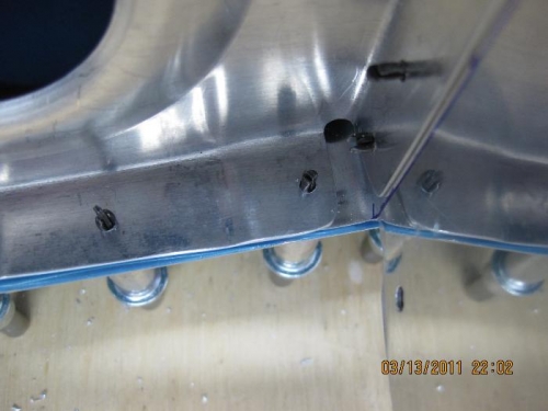

Today I did a repeat of the last three entries only this time on the right horizontal stabilizer. I did take a few close-ups of a few areas that I didn't before. First picture is of the notch at the aft end of the HS-404 rib and how it is nestled between the HS-714 & HS-710 angles. Both sides came out quite well and I am very pleased with them. The second picture is showing the edge distance (or lack of) at the forward end of the HS-405 rib. Most build logs I have read showed the same problem and one fellow contacted Van's about it and they told him it was not a problem and to just build on, so that is what I will do too since there really isn't anything that can be done bout it. In the last picture I just had to put it all together so I could see how it will look.
Aft end of HS-404
Aft end of HS-404

Both HS sides mated (That's an 8 foot table)
