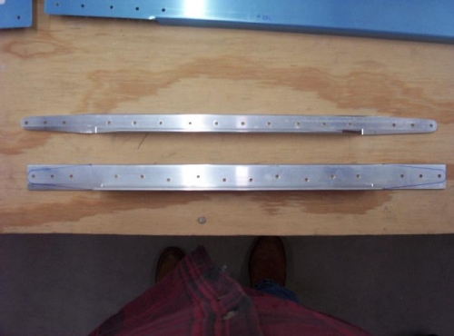

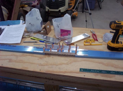

Not much time today so all I did was cleco the HS-710 reinforcement angle and HS-714 splice angle to the two HS-702 front spar channels and drill/match drill all the holes inboard of the HS-404/HS405 rib attach points. Then I removed the angles and tapered the ends using my band saw to rough cut and then the scotch brite wheel to finish them. Next I'll need to bend the ends at a 6 degree angle.
Trimming Reinforcement Angles
