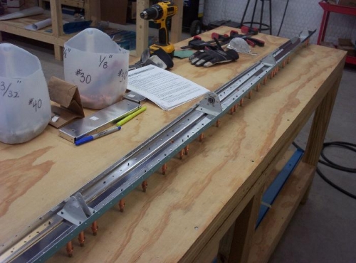

Brief Description:  Attached Elevator Hinge Brackets
Today I positioned the HS-412PP & HS-413PP elevator hinge brackets on the rear HS spar and final drilled. Also assembled the HS-411 brackets to the VA-146 bearing using AN470AD4-5 universal rivets. Final drilled the 411 bracket to the rear spar using a #12 drill bit. Next I need to mark everything with a sharpie for disassemble so I can debur and prime.
HS-411 Brackets & VA-146 Ready  for Assembly
First Rivets
First Rivets
All Brackets Attached
