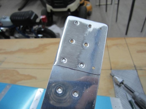

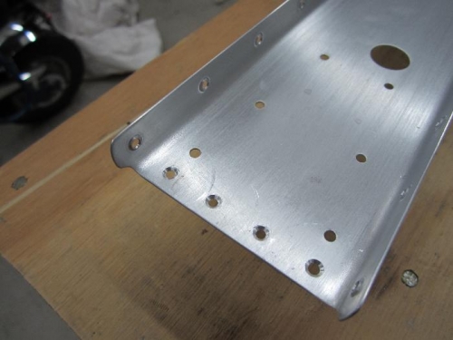

I removed, deburred and dimpled the left E-702 spar, E-705 root rib, E-703 end rib and E-704 counterbalance rib as well as the E-701 left elevator skin. I also machine countersunk the E-705 attach holes on the forward face of E-702 where the WD-605 elevator horn will be mounted over it. Then I beveled the inboard and aft edges of E-713 where E-713 overlaps the spar and rib flanges to provide a smooth transition between the counterbalance skin and the E-701 elevator skin.
E-705 attach holes countersunk on E-702 spar.

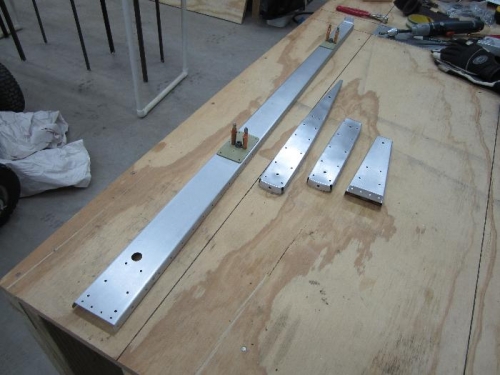

Ready for some primer.
