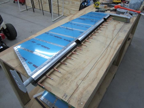

Date:  2-13-2012
Manual Reference:  6-13
Brief Description:  Rolled Forward Edges of Right Elevator
I rolled the forward edges of the right elevator using a 3/4" pipe. I roll one section at a time starting at the top so when I got down to the bottom section I found my pipe was interferring with the control arm so I just cut a length of 3/4" PVC pipe to get the job done. I used some electrical tape to mark the edge of the overlapping top skin so I could prime the area on the bottom skin that would be overlapped.
