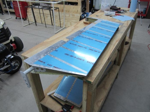

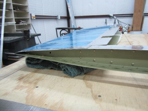

I started off today by putting a dab of "The Right Stuff" gasket maker on the last rivet of each trailing edge stiffener to help absorb vibration in hopes of preventing cracks. After doing that I inserted the right elevator skeleton into the skin then clecoed and riveted everything together.
