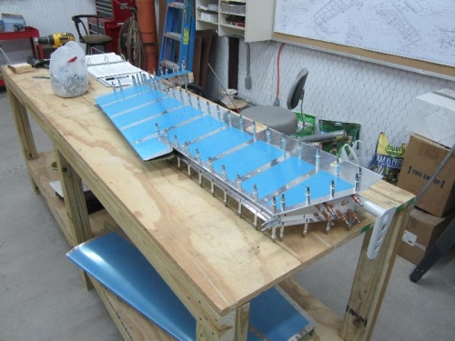

Brief Description:  Assembled Right and Left Elevators
I clecoed the E-709 root rib right to E-702 right spar and clecoed E-705 root rib left to E-702 left spar and final drilled to #40. Then I clecoed the E-701 skins on to the understructures. I then clecoed and drilled the WD-605 right and left elevator horns on. This is where I will leave the left elevator and finish up the right elevator.
Right elevator assembled.

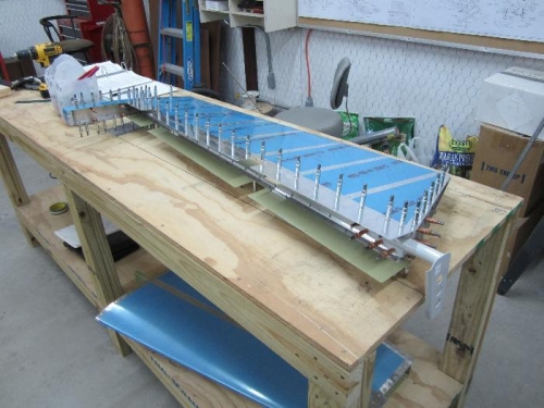

Left elevator assembled.
