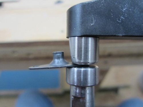

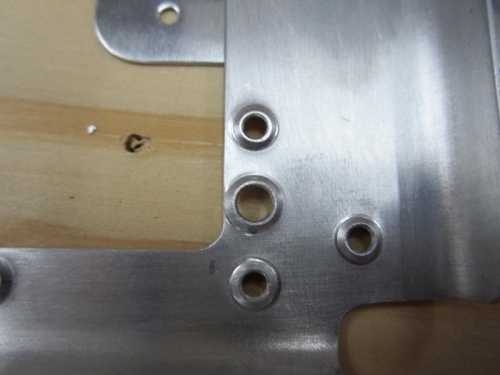

I dimpled the trim reinforcement plate to fit the skin as well as the nutplates. I also dimpled the nutplates using the female dimple die that I ground down so I could get into tight areas such as this.
Reinforcement plate dimpled.
Ground down female dimple die to fit.
Nutlates dimple nicely or they can be countersunk.
