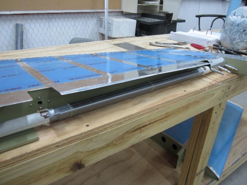

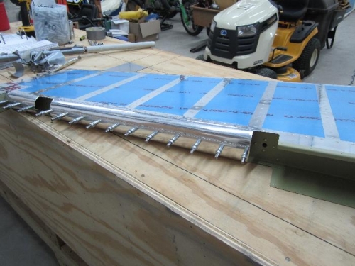

Brief Description:  Rolling Leading Edge of Rudder
I rolled the leading edge of the rudder in sections starting with the top and working my way down. I used duct tape around a 3/4 in. steel pipe the whole way across each section so I could get a nice uniform bend. First on the left skin then on the right using two pliers and finally clecoing the sides together. Then on to the next section to be rolled.
