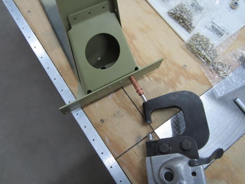

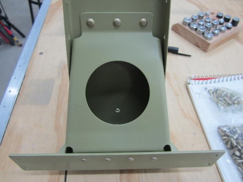

Brief Description:  Riveted Rudder Brace
From looking at a few other build logs I found it is a good idea to go ahead and rivet the rudder brace on now before riveting the skin on. If you wait until after the skin is on you won't be able to use solid rivets where the brace attaches to the bottom rib.
