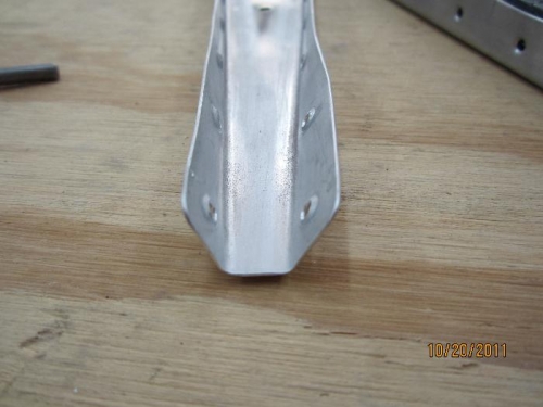

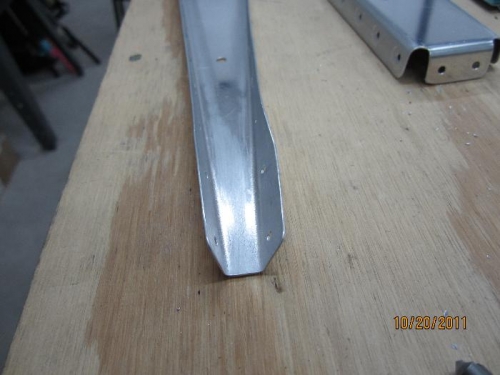

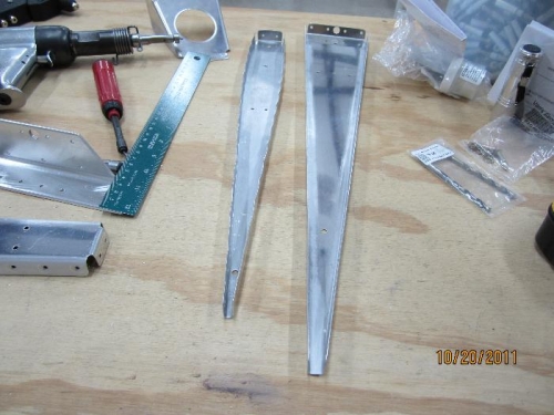

I didn't feel like fooling with it yesterday so today I spent a little time in the shop to spread apart the tips of the top and bottom ribs so I could get the few hard to reach holes dimpled.
Bend open a bit
Dimple
And bend back
