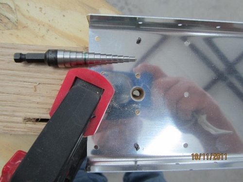

R-904 Bottom Rib
This is how the R-904 bottom rib looks after the center hole of the forward flange is enlarged to 3/8" using the unibit. Not much edge distance but this is how it should look.
I used scrap wood clamped to the back
