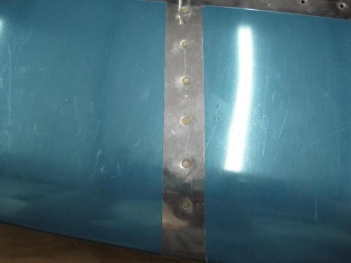

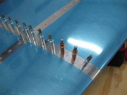

I had to drill out a couple of bad rivets on the bottom of the left HS-707 rib. Ended up enlarging the holes so I just drilled them out with a #30 drill bit and used a couple of oops rivets instead. It ended up looking very good.
The two copper mistake markers
Gotta love oops rivets
Another look...not bad.
