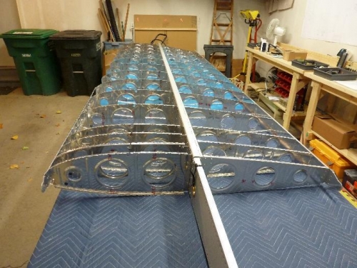

Cleco and rivet front main ribs and spar on right wing.

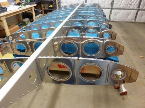

See 14-03 notes in my plans. Modify bottom row and 3 up from bottom on the right rear wing spar doubler W-1207B inboard end. Replace surface rivets with CS4-4 flush rivets. This is done to avoid possible interference with flaperon. This was done per suggestion by Scott Malcomb (RV-12 builder, Eagles Nest) at Oshkosh 2014 and Vans Aircraft email. See picture of finished mod. on left wing on 8/6/14. Here is body of email from Vans to Scott approving this mod:
> From: "Joe Blank" > Date: November 6, 2013 at 1:54:04 PM EST > To: Scott Malcomb > Subject: Re: RV-12 - Section 39 > > Scott, > > I ran the issue by both Van and Rian here. Both agreed that the offending rivets could be replaced with CS4-4 rivets to alleviate the interference issues. The rivets are predominantly in shear to the head shape should not affect the strength much. > > Another possible fix would be to lightly file the heads to remove any rough edges. > > Best Regards, > > Joe Blank > Airshow Coordination - Builder Support > joeb@vansaircraft.com > www.vansaircraft.com > 503-678-6545
