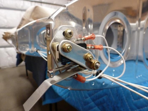

Brief Description:  Finish stall warning switch install & adjust
Manual 16-02 steps 6 and 7, install stall warning assembly, used Noalox anti-oxidant paste on mounting base and mounting screws.
Manual 16-03 steps 1 - 6, adjusted the stall warning with wing skin clecoed on. Took some time but it appears to be adjusted correctly. Had to bend the micro-switch lever slightly for proper adjustment.

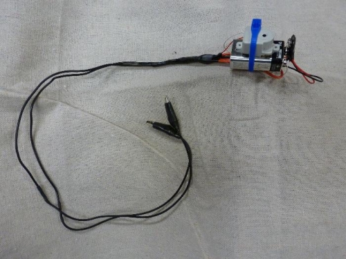

Spent some time to build a continuity tester with small buzzer and 9V battery with aligator clip leads. Tested the wiring.
stall warn switch installed
continuity tester
continuity tester
