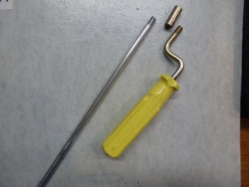

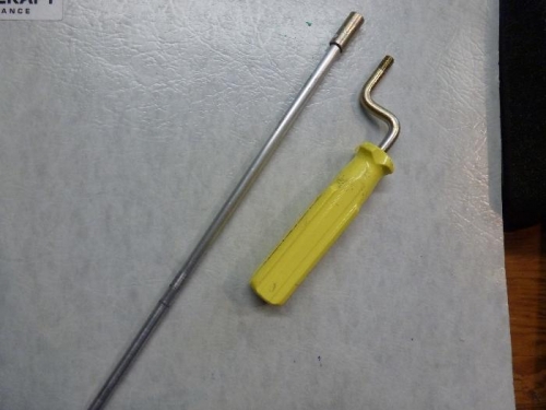

Brief Description: made an extended tool for the deburr bit
Bought a 1/4" aluminum rod at Home Depot and a 1/4-28 die to thread one end so that the threaded pipe would fit on it to make an extension for the deburr bit. Will use it to reach the engine mount holes for deburring.
