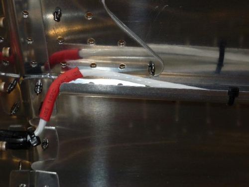

Manual 10-08 steps 4 -5, route elevator trim wiring. Note I added 2 layers of heat shrink tubing where the wiring cable passes over a portion of the tailcone. This was done to help avoid any vibration damage over years of operation.

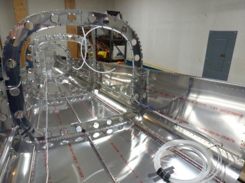

Manual 10-09 steps 1 - 7, install static ports using rivets as directed. Used large clamp and socket on the inside with punch into the rivet to eject the center. No hammering required. Ran plumbing as directed, installed 2 layers of heat shrink on the poly line that routes to the front where it passes over a portion of the tailcone to help avoid any damage to the poly tube over years of operation and vibration.

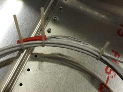

image 2 shows protection of the bare trim cable pins to avoid damage during storage before hooh up.
heat shrink over trim cable
heat shrink over connector pins
static plumbing completed
