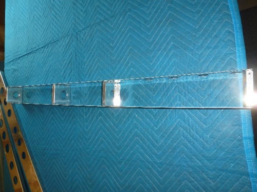

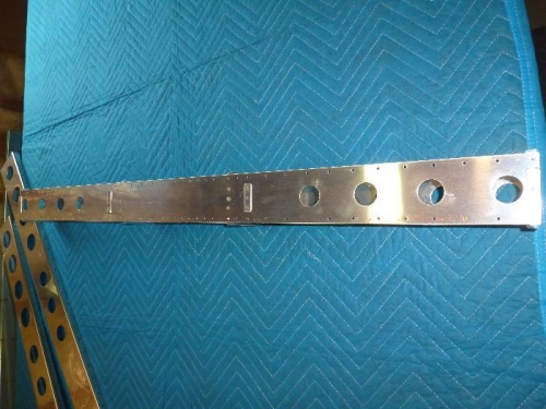

Manual 09-02 - finish all deburring of holes and edges of horz. spar caps.
Manual 09-03 step 1 & 2 - cleco and rivet horz spar caps, spacers and ribs.
Steps 3, 4 & 5 cleco HS-1202 and HS-1203 spars to the spar cap assembly. Cleco top and bottom horns and match drill. Deburr horns.
horz stab spar
horz stab spar
horz stab spar
