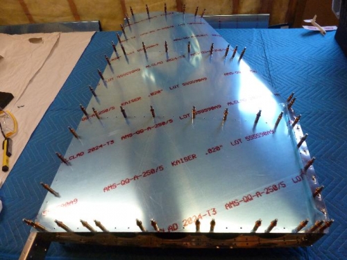

Brief Description:  Vert Stab main skin
Deburred all outside holes and all edges on vert stab skin. (Inside holes done previously.)
Cleco on to vert stab skeleton. Further radius removal needed on the VS-1202 spar and VS-1205 and 1206 ribs for proper fit.
After cleco together again and did an inspection inside I noticed two small flange tabs on VS-1207 had bent and not engaged with the cleco. Put a 3/32 cleco in and it fit okay.
Removed all clecos and inspected part. Hole was incorrect size so I drilled to #30.
Refit the skin with clecos on both sides with good fit.
Took longer than expected due to multiple times installing and removing clecos.
Ready to start riveting.
