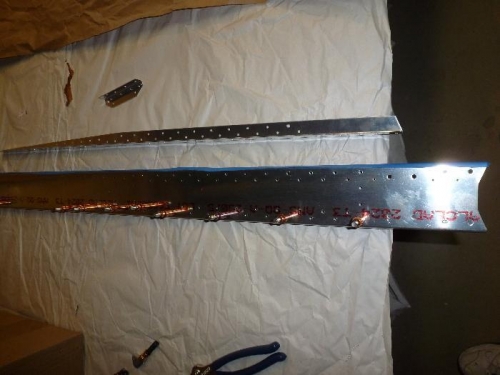

Brief Description:  Match drill #30 holes
Match drilled 75% of the #30 holes in the rudder spar web and flange on one side.
(not shown) Filed and ScotchBrite the bearing hole of the inside rudder hinge pieces to allow the bearing to fit inside it. Retouched up the primer on the hinge pieces to get ready to rivet.
