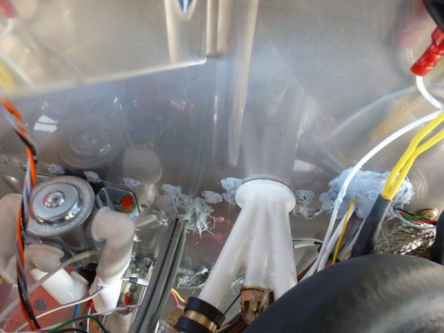

adjusted thottle cables, misc
Manual 50-06 steps 2 & 3 - readjusted the throttle cables on the carbs both left and right.
Manual 50--04 and 50-07 step 7 - applied firewall sealant on the throttle, choke and heater cables, and applied to the wiring grommet.

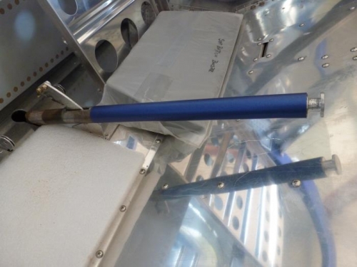

Verified Manual 46-16 steps 8 & 9 for the fuel overflow line wiretied near the gascolator.
Applied blue wrap to the flap handle.
heat silicone on firwall
blue wrap on flap handle
