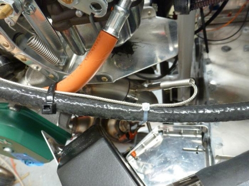

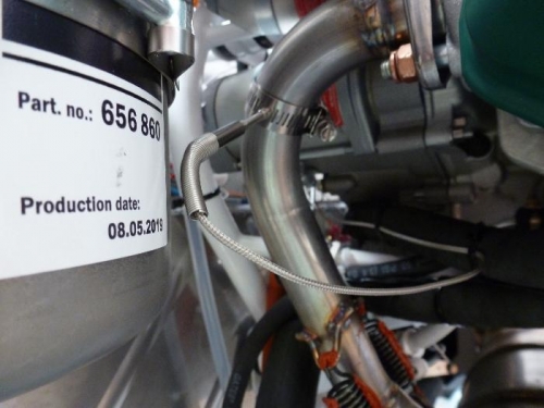

install EGT sensors
Manual 48-07 steps 1 & 2 - install two EGT sensors, one on Cyl. #3 and one on Cyl. #4. Had to slightly enlarge the holes in the exhaust tubes with #30 drill bit for sensor to fit. Holes were barely too small for the sensors to fit inside.
#3 cylinder sensor
#4 cylinder sensor
