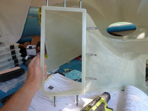

Brief Description:  sand and fit the cooling duct for radiator clearan
Manual 49-13 step 9 - 12, sand and fit the cooling duct interface using 1/4" spacers on the radiator edge. partial step 13 sand the locations on the duct and interface where they will mate with flox epoxy.
interface clecoed cooling duct
