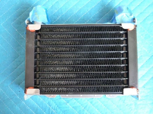

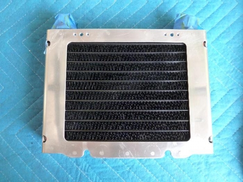

Brief Description:  finish fabficating oil cooling box with radiator

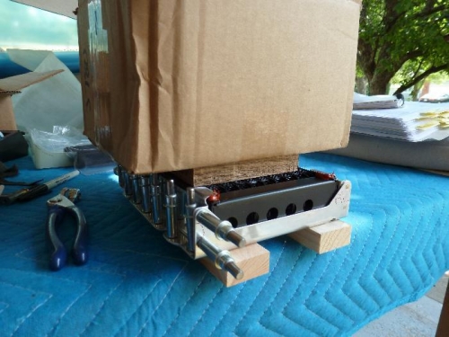

Manual 49-11 steps 9 & 10 partial, RTV and cleco bottom of oil cooler box, steps 12 & 14 apply 20# weight in a box to the assembly to set the RTV, apply RTV to tabs that hold the radiator.
Manual 49-12 step1 trim and sand the cowling colling opening
Manual 49-13 step step 1, trim and sand the cooling duct interface
Manual 49-11 finish step 11 rivet oil cooler box bottom, steps 15 & 16, insert plugs into oil radiator to keep debris out.
weight on top to set RTV
