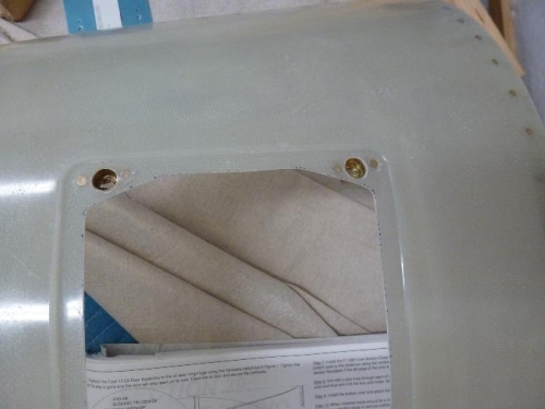

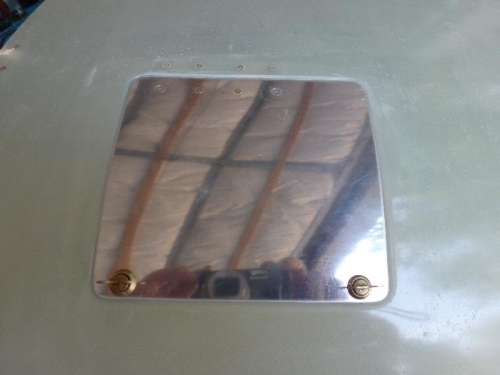

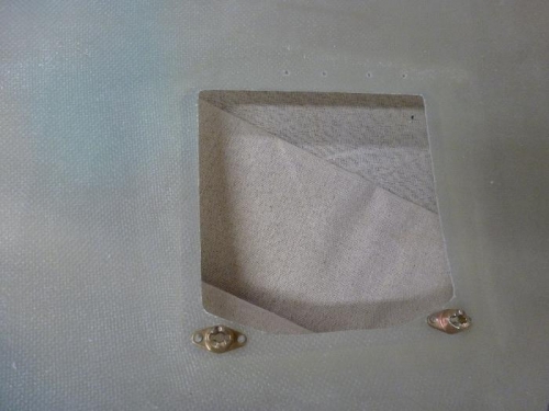

Manual 38-08 steps 3 - 7, drill oil door latch holes in top cowling, assemble oil door, rivet door latch to cowl, drill out 1/4 holes in the hinges to fit the bushings, drill #40 holes for hinge brackets.
oil door hole from inside
oil door hole from outside
oil door cover inserted
