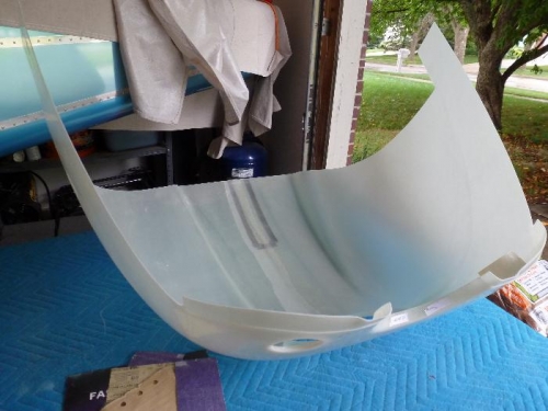

finish sanding bottom cowling, cut slot
Manual 38-02 step 1 finish sanding bottom cowling, steps 2 &3 cut bottom cowling flange and sand, step 4 clamp cowlings, mark 6 holes and drill two #40 inboard holes. Step 5 cut and sanded the slot on the bottom cowling for the front wheel support.
bottom cowling sanded
