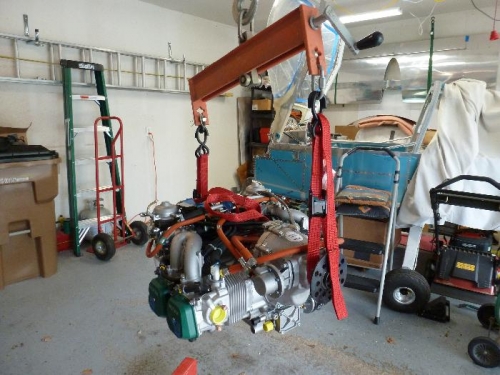

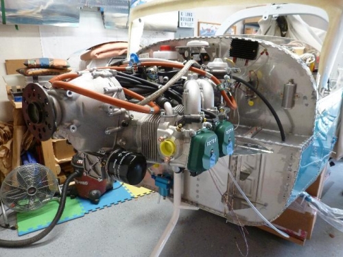

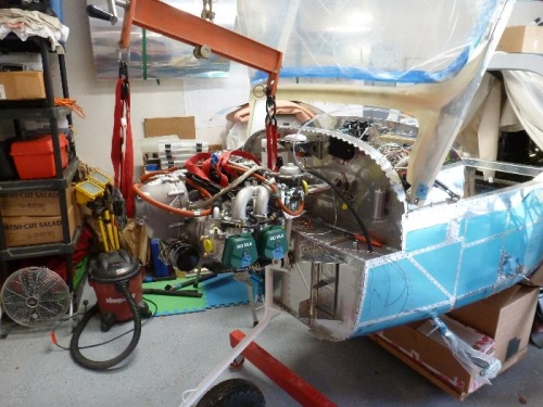

Deburred the lower engine mount holes with the new extended deburr tool.
Manual 46-08 steps 4 and partial 5. Using the 2 ton engine hoist borowed from Tre Wilson and using two straps to hang the engine, bolted the engine to the fuselage. Tightened the bolts enough to prvide good holding poweer but did not torque.
