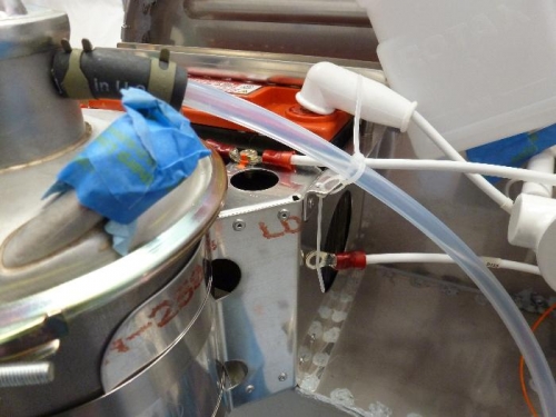

Brief Description:  connect oil tank vent, cooling overflow bottle

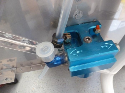

Manual 49-06 step 5 finish, partial step 7 - connected oil tank vent hose and wiretie plus install hose clamp on the gascolator. Need to tighten the gascolator bolt to torque.

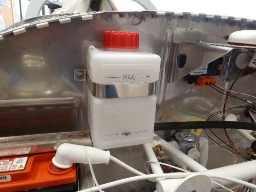

Manual 49-06 steps 9 - 11; maount the cooling overflow tank after applying red high temp RTV. Attached the cooling overflow hose.
Applied 2000 degree 3M sealant to the rivets in the firewall attaching the heater door.
oil tank vent tube
oil tank vent tube
oil tank vent tube at gascolator
cooling overflow tank w/hose
