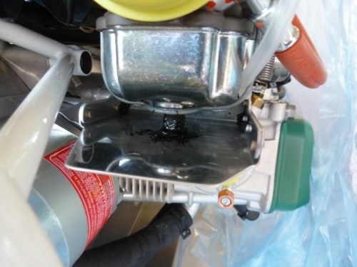

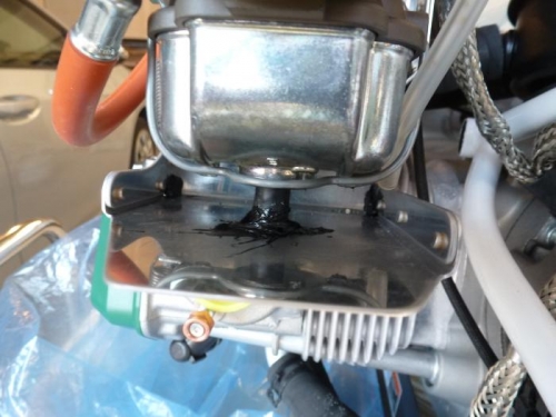

Manual 46-07 steps 3 and 5, cut the H173 hose for the dampeners. Sannded the drip trays where the dampeners will be potted inplace with fuel tank sealant. Put them in place and potted with fuel tank sealant.
