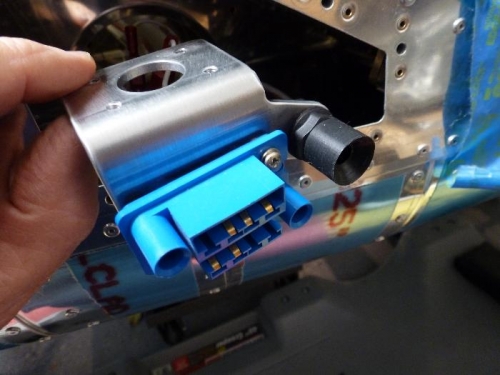

modify fuselage AOA fittings and attach
Notification 16-12-14 steps 20, 21 remove existing fuselage wing wiring connector and bracket.
Steps 24-27 partial, tap holes in new bracket, attach FLF-00012 AOA tube fitting and guide (picture 1)

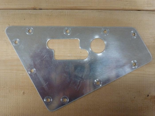

Step 30, step drill 3/4" hole in existing fuselafe cover of wing wiring connector. (picture 2)
connector attached to new
fuselage cover plate modified
