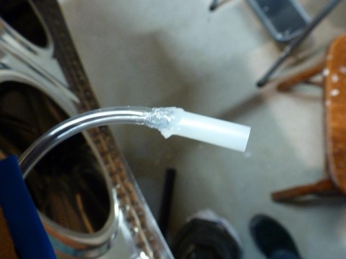

Brief Description:  run AOA tubing, make fitting, RTV
Notification 16-12-14 AOA steps 8, 12 and 13. Run 1/8" tube through the wing. Used a 1/4" dowel 4' long with string taped on each end. Taped tube to string on one end after feeding dowel through the wing. Worked well. RTV tube to rivet, fabricate 3/4" long 1/4" tube and RTV 1/8" tube to it.
RTV use is Permatex #75151 bought at Home Depot
Deburred F-00034 bracket that will be use on the fuselage.
RTV 1/8 tube to 1/4 tube
