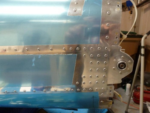

Brief Description:  remove stabilator, start installing rivnuts for fa
Removed the stabilator. Dteremined that the two glued on washers on the left side came off when the stabilator was attached. Will work to get a better gap for clearance. Based on measurements I need .005 to .008 larger gap for the washers to clear. Will work on this later.
Manual 12-10 steps 1 - 5 partial 6, Drill #40 holes for attachment of rivnuts. Install about half of the rivnuts. Had trouble squeezing the 3-3.35 rivets. The rivets would fold over. Detemined I need to use 3-3 rivets instead. That worked much better. Ran out of time to finish.
some rivnuts installed
