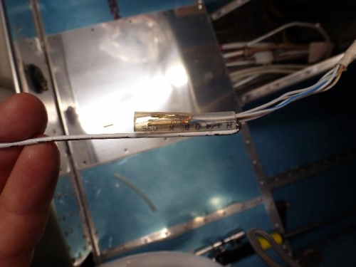

Review of Manual 31B-04 routing the pitch trim wiring from aft to forward in the fuselage. Manual 31B-20 & 21, 23 aft pitot tube and wiring to ADAHRS area in the tailcone, 31B-22 noise filter wiring and running of pitch trim and aft pitot tube routing.
Used length of poly tube on the pitch trim cable end to protect the connectors when routing (see pic) through the fuselage foward, also used hanger wire to catch onto it.
Built board to put over the center fuselage support for help of climbing into the fuselage while routing wiring and tubing.
poly tube and hanger wire
