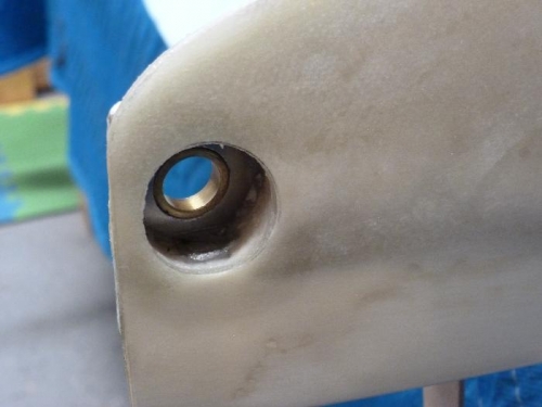

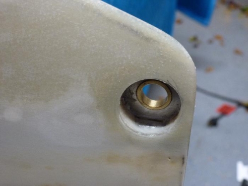

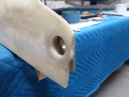

Brief Description:  add epoxy/flox to space fiberglass from fuselage
Added epoxy/flox mixture to left and right canopy pivot points to space the fiberglass out about 1/16" for clearance from fuselage skin when the canopy is opened.
left canopy pivot point
right pic at different angle
