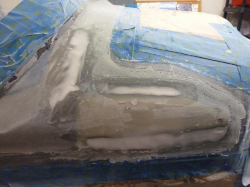

remove middle pealply, sand and fill gaps

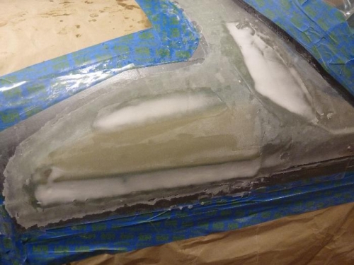

Manual 34-15 step 5, removed pealply from the middle. Start sanding with 60 grit on both sides. Filled in gap areas with fast cure #206 epoxy/microbeads mixture.
left area filled in w/epoxy+beads
right area filled in
