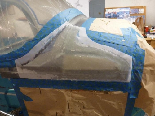

Brief Description:  fiberglass right side of canopy

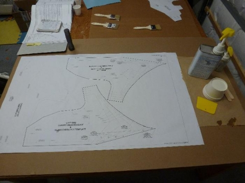

Manual 34-14 step 5 complete for right side wax, steps 6 -8 complete for the right side fiberglassing. Used pattern as with left side under the ply 1 wet process to position the ply correctly. Worked well. Also applied peal-ply over the lay up. Used slow hardener.
Removed peal-ply on left side.
right side fiberglassed
parttern used as template
