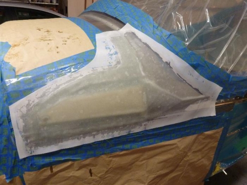

Brief Description:  wax left side and apply fiberglass to left side
Manual 34-14 step 5 for left side only wax only.

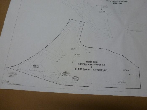

Manual 34-14 steps 6 - 8 left side only. Used uncut pattern with edges of ply #1 made bold with a Sharpie underneath the Saran wrap. Worked as a great way to align the fiberglass as it was wetted to keep it in the proper place. Applied plies 1 - 5 as well as peal-ply material. Used slow hardener.
left side fiberglassed
template used to align glass
