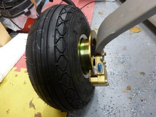

Bolt on mains axles, attached wheels
Manual 35-04 step 1 finish, bolt on mains axles with one 3/4 degree shim on each side. Torqued the bolts to 80 in/lbs.
Manual 35-04 steps 3 and 4, Install the main wheels and the brake assemblies. Torqued brake assembly bolts to 100 in/lbs.
wheel and brake assembly

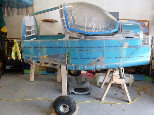

side view
