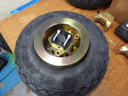

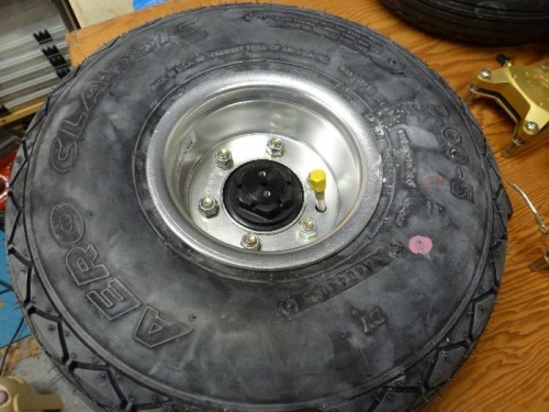

Finish second main tire and assemble brake conn.
Manual 35-02 steps 6-8 finish the last main gear tire and wheel hub. Torque all bolts to 100 in/lbs per Matco, pump to 28 psi.

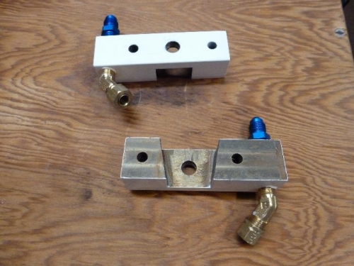

Manual 35-02 step 10, install brake system fittings in two attach brackets. Use Loctite 567.
brake fitting brackets
