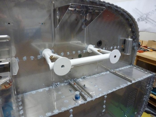

Manual Reference:  35-02
Brief Description:  Install engine mount, start on wheels and tires
Manual 35-02 step 2, bolt the upper engine mount. Torqued to 150 in/lbs which is the highest setting on my torque wrench. Then tightened a little more to line up the castle nut with holes in the bolt and install cotter keys.

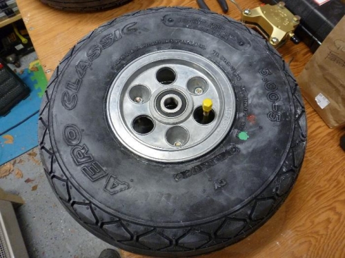

Manual 35-02 steps 3 - 5, Install inner tube in tire and mount on the front wheel hub. Torqued the whell hub halves bolts to 80 in/lbs per Matco hub maker. Pumped to 22 psi.
Manual 35-02 steps 6 - 8 install inner tube and mount on one main gear hub. Torqued all bolts to 100 in/lbs per Matco hub maker. Pumped to 28 pounds.
upper engine mount
upper engine mount
