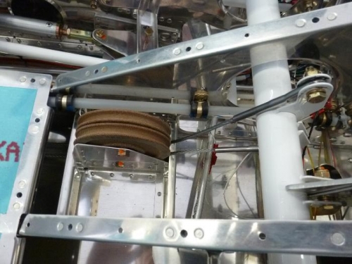

Number of Hours:  3.00
Manual Reference:  32-13
Brief Description:  Install/route stabilator cables & pulleys
Manual 32-13 steps 2 - 5, install and torque cable pulley bushing, connect stabilator cables, grease them, install pulleys and route the cables aft. Used a coat hanger wire to fish the cables aft. Torqued the pulley mounting bolt. Appplied torque seal.
Applied wire ties to some wiring to clean up.
Will finish cable connections when tail cone and control surfaces are installed later.
