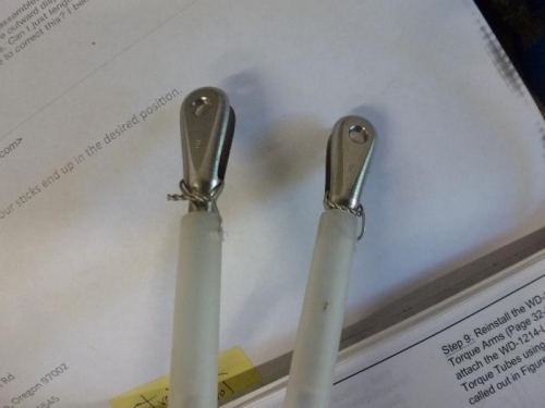

Brief Description:  finish install of stabilator/rudder cables and sle
Manual 32-11 step complete tighten last two forward screws on sleeves.
Manual 32-11 steps 3, 4, 7(partial), drill and safety wire the aft sleeves on rudder cables plus attach forward end of cables temporarilly to rudder pedals. Finish steps 5, 6, 7 later.
Manual 32-13 steps 2, 3 - start install of forward portion of the stabilator cables. Cables attached to control stick mechanism. Torqued cable bushing to 30 in/lbs.
aft end of cables saftety wired
