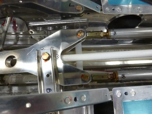

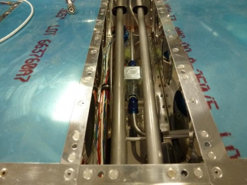

Brief Description:  fabricate and attach flaperon pushrods
Manual 32-06 steps 1, fabricate the two flaperon pushrods

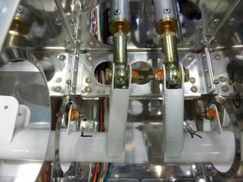

Manual 32-06 steps 2 - 5, assemble flaperon pushrods onto flaperon mixer and flaperon torque arms. Torqued the pushrods onto the mixer to 30 in/lbs and applied torque seal. Torqued the torque arms onto the bearing to 30 in/lbs and applied torque seal. Could not torque the pushrods onto the torque arms due to lack of clearance but applied torque seal.
Note: Inspected both flaperon torque arms for full welds per Safety Alert R4-12 (3-17-11)
Flaperon mixer with pushrods
flaperon pushrods
flaperon pushrods
Flaperon torque arms
