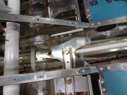

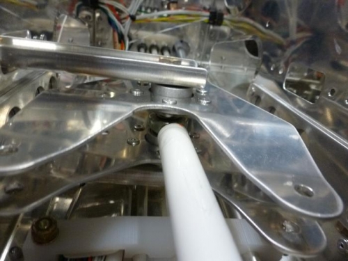

Assemble flaperon mixer arms
Manual 32-04 step 3 assemble flaperon mixer arm, tricky to get bottom blind washer inserted, used piece of scotch tape to old the washer temporarilly in place. Torqued AN4 bolt to 75 in/lb and applied torque seal.
top view, see torque seal
side view
