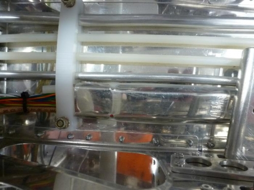

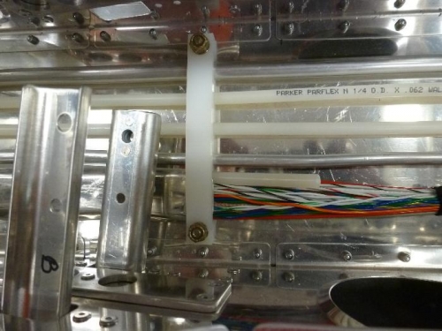

Manual 31B-23 finish step 1 install Wire Cover (protects wires from flaperon mixing bracket pieces.
Step 2 partial, installed a short piece of tubing to hold room for future install of Aft Pitot Tube line from tail cone section when installed.
Step 3, install three Wiring System Block covers
wiring blocks, see tube spacer
see wiring cover
