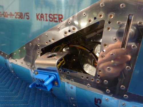

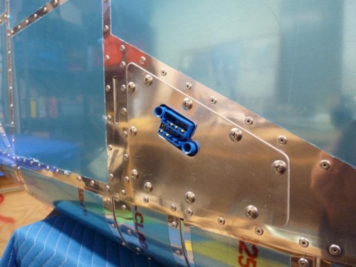

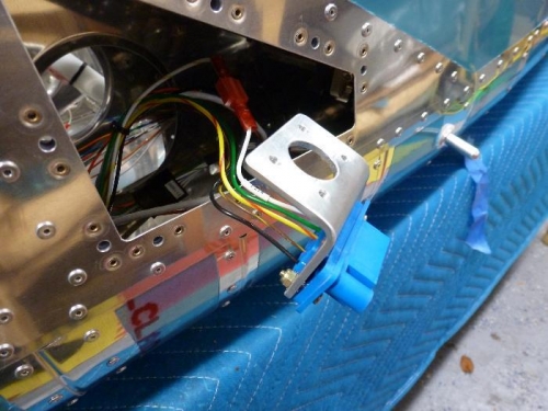

Manual 31B-24 steps 1 - 5, attach wing wire connectors to brackets, brackets to fuselage and attach covers. Had to modify slightly the right side bracket to fit the connector correctly. Had to drill out the fuselage mounting holes for the connector brackets to #21 for #8 screws to work. Deburred holes.
