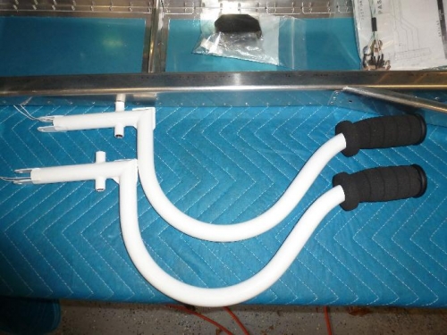

Brief Description:  install control stick grips and wiring
Manual 31B-12 steps 1 - 3, routed wiring through control sticks, installed Ray Allen Company G101B grips. Used black "rescue tape" wrapped aroung control stick to tightly hold the top switch section of the grip. Used washer on string to get a path through the control stick to pull the wires through.
