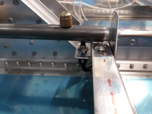

Brief Description:  finish spar pin switch wiring and switch install
Manual 31B-10 steps 4 completion, 5 - 7, Vans Notification 15-09-15, drill and mount switch mounts pieces, wire and test. Used Notification for details. Used beeper continuity testor to be sure switch activates correctly. Used 7 washers as spacers for each screw that holds on the switch mount bracket.
left spar pin switch

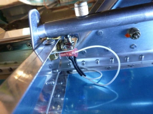

right spar pin switch w/ground
