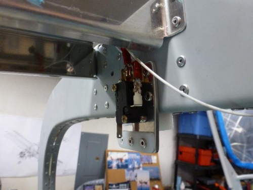

add canopy latch safety switch
Manual 34-11 steps 1 - 9 (skip 8 not needed), install the canopy latch safety switch
Manual 34-10 complete step 1, bend the canopy frame tube to cause canopy latch to not rotate too easily, also greased the latch tube.
safety switch
